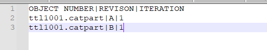

My loader read the input values from a csv file and create the epmdocuments accordingly.
In csv file, i have entries to create two revisions of same object back to back. for e.g.,
A.1 created successfully, while creating the same B.1 using same API, it fails with uniqueness
