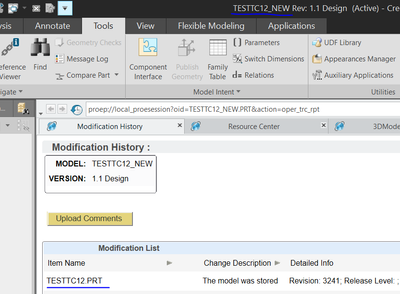

    Our requirement is to standardize the part name in Windchill before migrating into Teamcenter. Actually as you said it renames all the version, but in file history some how it's not syncing.
For example,
The part TESTTC12 has been renamed into TESTTC12_NEW, but in file history it's not saving. This causes error in drawing that " Model "TESTTC12_NEW"  not retrieved.
Thank you in advance!
Sorry to see you go (Windchill to TeamCenter). Note that (I am pretty certain) that when you rename CAD files in Windchill, the actually binary file is not updated. @BenLoosli is correct that rename (name, number or filename) are master attributes and apply for the entire history. So the entire iteration and version history are impacted. BUT, the CAD files as rest in the vaults remain as they were untouched. Creo stores filenames internal as its references to components, formats, drawings, etc. The ONLY time a rename event is passed into a CAD file is as it transferred to a workspace. This is easy to test. Pull up some files in a workspace. Then do a rename in Windchill in a separate browser. Its only when the workspace detects a rename event, does it pass that data and update files locally.
So, if you plan is to migrate data from Windchill without transiting through a workspace on its way to TeamCenter, you've got a big problem.  Even old rename events that occurred might not have made it to all iterations.  It is possible to pull down older versions of files into a workspace however, this will make your transfer of data much more complicated. At least you should limit things to only take the latest iteration of each CAD file version.

The rename is ONLY taking place in Windchill. there is no mechanism to push the changed names to the actual CAD objects except by loading the objects into a workspace where Windchill can then do its ting with the CAD file naming. One of our 'rules' is that anytime an object is renamed in Windchill it MUST be opened in Creo to force the change into the CAD object structure.
I suppose you could write a batch script that would cycle through a bunch of file names that been renamed to update the information. You would also need to update all the assemblies and drawings that reference these renamed objects. Windchill knows the relationships, but TeamCenter does not so you need the relations update across the board BEFORE migrating the files to TeamCenter.
