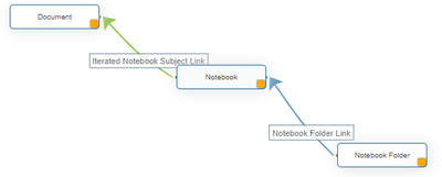

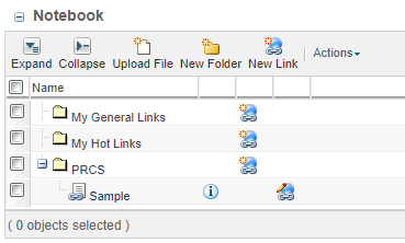

In one of our processes for a Document, the user is expected to upload an attachment into the Document Notebook section (in a particular folder).  I am trying to learn the tables involved to report on such an upload and potentially determine that one has or has not been done prior to a workflow task being completed.
Ex:  For a Notebook such as below...
... I can create a QB report to get the Document and Notebook folders...
... but I cannot find which table to add so that I can report the "Sample" attachment from the first image.
Help?

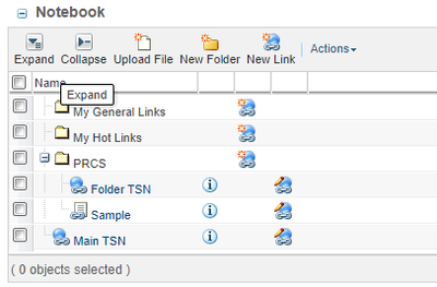

Hi Marco.  I can attach the Application Data table to the Document via the Holder to Content link type and see the primary or secondary content files.  But where do I link it to see the Notebook uploads?  The Notebook and Notebook Folder tables don't give a suggested link type between themselves and Application Data (Holder to Content is not available).
I have figured out how to list other content such as the Bookmarks, but still cannot find the uploads.
