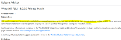

Use Case: As a developer I need to figure out which versions of 3rd-party libs are being used in different versions of Windchill
Description:
It used to be that you could download the Software Matrix for Windchill and in that document read about the software components bundled with Windchill. You could for instance see which version of commons-codec that was included. For version 13 this no longer sees to be the case.
Does anyone know if this is still possible? If not, then is there some other way to figure this out that doesn't involve decompiling the wc3rdPartyLibs jar and go through the class files.

Have you already looked at release advisor?
https://release-advisor.ptc.com/releaseMatrix?releaseId=1373
