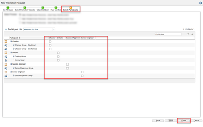

Set the participant as required at the time of promotion request creation in windchill
  • March 13, 2025
  • 2 replies
  • 664 views
Version: Windchill 12.0
Use Case: Currently, I am able to create a promotion request in windchill without selecting any members from the participant list. I want to add up a condition in the promotion creation page, when a user miss to select the required participant from the member list it pops up an error stating that the required members are not added, and the promotion request cannot be created without them.
Description:
When the promotion is created with this issue, the workflow gets stalled when the task is to be created for those missing participant and it cannot be recovered back. User needs to create a new promotion request to proceed further with.
I want to implement a way in promotion request creation where user is notified or there is some pop-up error/validation that checks when the user fails to add the appropriate users in the member list.
Is there a way we can add this validation or customization to our windchill?

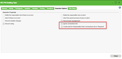

The Workflow starts with the creation of task for an individual to proceed further with, which would be the first drafting task. It gets stalled right there and then as there is no member to assignee that task to.
There are few options that we are using:
This allows us to ignore unresolved role and create a task for the unresolve role which is required but this cannot be used in the case of approver or reviewers task because this will create a task for creator which wouldn't comply with our policy. This will provide a loophole for the user to approver their own task.
The other solution is to add a condition if it finds a conflict, to go to the task where a user's can be added but our workflow is already huge adding up another condition on it doesn't seems viable at this point.
I want a solution where I can actually add a validation at the promotion creation page before it goes to any workflow.
In the image below: If I click on 'Finish' button then I would like to add a pop-up error message to let users know that it is missing participant and it won't allow them to create a promotion request without these members selection.

Hi @DN_11160103
I understand why you do not want to add the condition to the workflow but don't reject simple solutions 😄
The condition check in the workflow is simple solution that you can deploy during an hour.
A creation own validator could take more time.
PetrH
HelesicPetr
March 24, 2025
Hi @DN_11160103
Yes you can
Write own class for validation and register the validator
CS348425 - How to add a custom UI validator to the "Select Affected Objects"
Promotion Request create form submission validator
Wizard UI Validator
Windchill 13.1.0.0 Customization Guide - Adding Validation Logic for Actions and
Properties page 412
