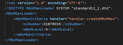

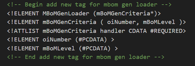

I am experiencing a critical issue with generating Manufacturing Objects in Windchill 12 using the MBoM Loader. This process worked correctly in Windchill 10 but is now failing in Windchill 12.
Process : I use a custom XML file (GEN.xml) to create manufacturing objects via command line and MBoMGenLoader.
Command used :windchill wt.load.LoadFromFile -d path/GEN.xml )
Issue: The XML file imports successfully with no errors reported in either the Method Server or Background Method Server, but the manufacturing object is neither created nor visible in the Windchill interface.
The handler method specified in the XML (handler.createMBoMGen) is not being executed at all.
DTD file :

GEN.xml :
Why is the handler (handler.createMBoMGen) not being executed during the XML load process ?

Hi @BRAHIM
Do you know that the csvtoxml map file does not contains this loader so it is not officially supported?
So the method could be changed in the new version so you would need to find an another method that works.
Or if you use own custom method handler then you could not implement it correctly in your new Windchill installation
