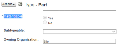

VladiSlav
(To:hlafkir)
I found a mistakes.
Type must be Instantiable.
Here's how to do it:
Just as I understand it, the generated token can only be used by the user who received it.
