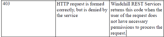

Hello everyone!
I try to execute a post request, but get this error:
{"error":
    {"code":
        "INVALID_NONCE","message":"A potential security problem was detected. Refresh the
         page and try again. If the problem persists, contact your administrator."
I found this article:
https://www.ptc.com/en/support/article/CS312447
It says that a token is needed, but I already added it and still does not work.
Here is the request that I execute to get the token:
http://server/Windchill/servlet/odata/PTC/GetCSRFToken()
Here is my code for the post request:

Tell me, please, what am I doing wrong?
Thank you in advance!

hlafkir
(To:VladiSlav)
Hi
The CSRF-NONCE is provided by the REST API end point :
https://<Windchill server>/Windchill/servlet/odata/PTC/GetCSRFToken()
I'm not sure that the "MY-TOKEN" string had been provided by this end point  🙂
Hicham
VladiSlav
(To:hlafkir)
Thanks for the answer!
Yes, I copied my real token there, but I just decided to replace it so. 😅
I apologize for being misleading.
Here is the real tokens format that I am adding:
F4a464/MVN5bbrRdYtbXq+TnODYTPq9qbbHS2OOWM+xlT80oT7XgpumOIboWGtAvILbsnp18ZOHnR3FiI7CBxZn0dOZuDo3fIMTRne2lBpIJIt8qe6/ptv+fIREML4k=
hlafkir
(To:VladiSlav)
ok thank you for this light.
Can you try that please (working fine for me). Just replace the user-agent and the PDMLinkProduct oid with your one. You will then see what is going wrong with your code :

Here is what the documentation says about this:
But I used the admin user.
