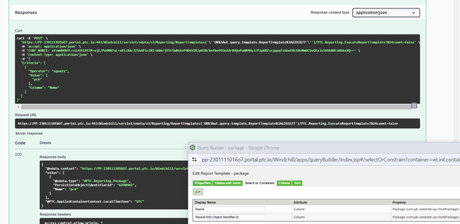

You can try WRS to get report template results
Check this article
CS254366 - Windchill REST Services (WRS)
Windchill Resources
https://windchilladress/Windchill/netmarkets/html/wrs/doc.html

This is Post request , But above shared url is working fine in without SSO system. I have send the basic credentials only.
Get request is works. if same steps followed above shared error have appear.
