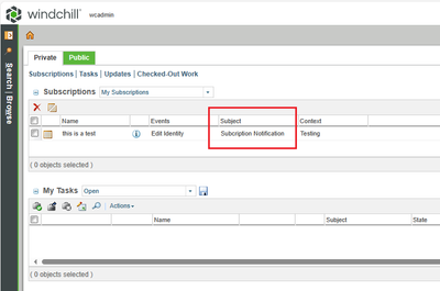

As seen in the attached image, I want to change the subject line in the red box.
Was able to figure this out.
To control the Subject Line of the Subscription Notifications, perform the following:
Find the following folder location:
Windchill\codebase\netmarkets\jsp\subscription
This folder contains the JSP files that affect the emails that come out for Subscription Notifications.
defineSubjectAndExpirationStep3.jsp affects the 3rd Page of the Subscriptions Creation.
We want to make the Subject a static value:
Add the following to line 26: enabled="false" hidden="true"
In Line 26, modify the value to be a static line such as "Subscription Notification".
After a Windchill restart, here is what the GUI looks like to create a Subscription:
Notice that we cannot change Subscription Subject.

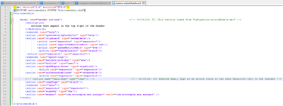

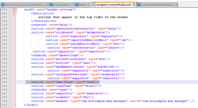

Folder Location: Windchill\codebase\config\actions
In there, you can find the following file: navigation-actionModels.xml
Find this part here:
Take that snippet and put into the custom-actionModels.xml file as so:
Comment out the section for emailPage.
*Remember to use wtSafeArea so that your customization is well-documented*.
After that, the Quick Links will no longer show "Email Page" as an action.
It's effectively disabled.
