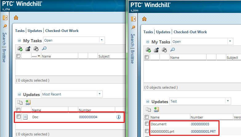

Hello, everyone
We are going to do some development based on Windchill's OOTB.
One of their requirements is as follows.
Someone in the user checks in the object.
Can I create a separate document or CAD tab to announce who checked in and which files were checked in for checked-in objects?
For example, User A, who is part of Product1, checked in part1.
All users belonging to Product1 can notice that User A has checked in part1.
Notices can be displayed on the homepage in the same form as a mission.
Is this possible? If so, what should I develop?
I'll wait to your help.

As shown in the figure, the PDMLink OOTB only displays update notices for users.
However, I want some users (product manager, etc.) can check the checked-in objects (documents, EPM documents). Even if it is an object that is not associated with a user!Image1.png

@JHall I want all of the displayed on the objects that the user checks in.
Currently , only the objects checked in by the user himself or checked out can be checked.
From the manager's perspective, he wants to know all the check-in and check-out situations that occur in the product or organization he belongs to.
As a result, administrators should be able to view all updates from other users.
All means only the products or organizations that belong to you.
Is it enough to deliver the my question point?
thanks

When you check in an object in PDMLink, the checked-in object is displayed in the home tab of that user.
However, this is only visible to the user who performed the check-in.
Organizations or product managers are encouraged to see all checked in objects in their organization or product, even if they do not check in.
Perhaps you might want to make the managers all Admins so they could see the items checked in and out by other users?
@JHall
How can I implement it?
thanks
tivancso
(To:CHASEONHO)
Hello why not create a Query Report that lists all the Checked-In Objects for a specific Product or Organization, then each manager can create their own Saved Report and then create a Data Monitor to run the Query Report Daily to see the results?
In PDMLink's Home tab, users can easily see which objects they have checked in or checked out of.
This is because it looks simpler to check in the Home tab than to create and view reports.
Therefore, the administrator (product, library manager) should be able to see the objects of the user's check-in or check-out belonging to his / her home tab.
