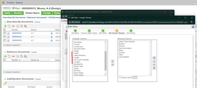

Where do i see the Part Describe Link Attribute ?

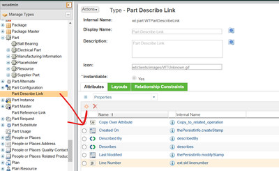

I have created a custom attribute on Part Describe Link (Line Number).
Unable to find it in Part's Related Object.
