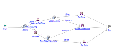

Workflow role is not working
  I have created one simple workflow in that second activity i have selected designer as participant role .But when i select participant particularly it wont send task to assigned role user.But when we select individual user it will work properly.
In role i have selected required < any. It assigned to creator itself.

The workflow process needs to find the user(s) assigned to the Designer Role at the time that activity is fired.
Easiest and simplest way to test is to add that Role to the Product/Library where the workflow is running and assign a user to that Role in the Product/Library context team.
More complex can involve the team assigned to the PBO object (e.g. change request) via OIR, but get confidence using the context team Roles first.
Assign more than one user to the role in the context team and see that all get the task and any can complete it.
Experiment with assigning a group (Org level) the context team role and see that all in that group get assigned the task.
  Thanks for reply but it resolved i have added that role in Default team template and works fine afterwards.From utilities < team administration < Default team template < add role

Seams adding the role to the "Default" team template is the way described by PTC
See : https://support.ptc.com/help/windchill/whc/whc_en/index.html#page/Windchill_Help_Center%2FTeamTemplateAdminOOTBAssociate.html%23
The Default team template does not contain any roles. If your site uses workflows to manage objects other than change objects (such as documents and parts), you must add roles to the Default team template and any other team templates you create for use with non-change objects.
