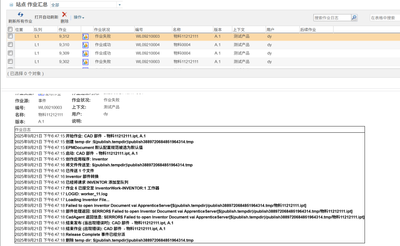

与Inventor集成后,中文名称作为文件名的模型,在生成可视化时失败,(相关工具版本windchill 12.1,creo view adapters 8.1,creo view 8.1,inventor 2020)错误信息:Failed to open Inventor Document vai ApprenticeServer[$(publish.tempdir)/publish12669499619298418784.tmp/零件4567813.ipt]

failure:

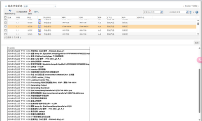

success:
