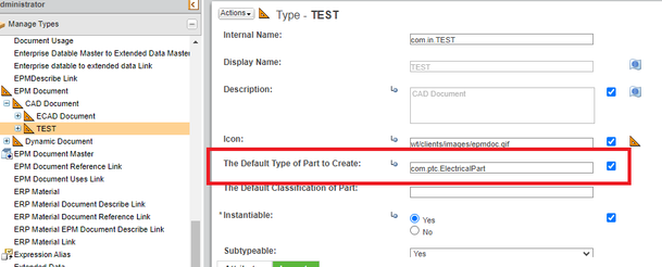

You need to define 2 CAD SubTypes where you define different WTpart type in type and attribute management.
Then you can set model parameter to define what CAD Document subtype should be used for that model and then the auto-generation uses WTPart subtypetype defined in the type and attribute management
CS41665 - How to create subtypes CAD Document
So your start models just need to contain that parameter with correct value.

Hi @HelesicPetr and thanks for that!
So there isn't a way to do this association without having a CAD subtype, I take it?
I'll give this a try.

Yes there is a way with customization. I showed you how to achieve your needs by OOTB functions.
With customization you can do whatever you want. You just need to know what is condition so set correct subtype.
For example @RandyJones has mentioned one option with custom class that is configured in preference management for autoassociation.
