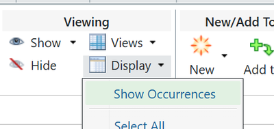

In the Display dropdown, click Show Occurrences:
Hi @kirkwemple,
Anurag
