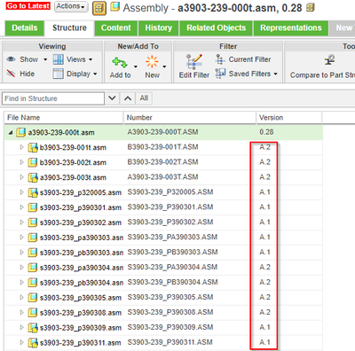

The issue is if I open a previous Released iteration of a CAD Assembly, the structure is not showing the previous iterations of the downstream sub-assemblies, rather it shows the latest version of all downstream items. For example see the image below,
In the structure, the top level asm is last Released  0.28 version but all other underlying items are latest Revised version A.
Also if I open it in CREO it shows some red flags for missing references due to updates after revision.
Does anyone know how to get the same iteration of all downstream items when it was last Released together with top level along with the references? Is there any preference option that I need to change to get this?

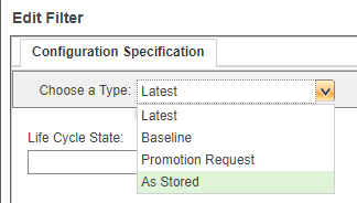

Usually if you work just with CAD then the filter "as stored" should work for you if your change process works properly
The preference filter as matured works really just for WTParts because there is not option for as stored configuration.
PetrH.

HelesicPetr
(To:Pranav_p2)
Hi @Pranav_p2
Your requirement is not possible now.
The Users have to be trained to use the filter with "As store" configuration.
PetrH

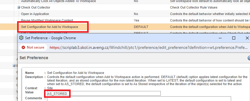

HelesicPetr
(To:Pranav_p2)
Hi @Pranav_p2
I was not accurate little bit. You can set a preference for  "Add to Workspace: function where you can set as stored configuration.
PetrH

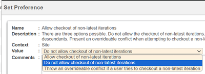

Dobi
(To:Pranav_p2)
There is also a preference to "allow check out of non latest iteration" that can be set. That would allow you to make changes to CAD that is not latest but then when you check it in, that will be the new latest version.
I would use this cautiously, though.
If you're wanting a snapshot of a set of iterations for a released assembly, you can also take advantage of Baselines. You'll still have the same issue if you want to edit non-latest files but that would give you a Windchill collector that will preserve your iterations for a version of interest of your assembly.
BenLoosli
(To:Dobi)
I would add an additional caution on changing either of those settings on a permanent basis. They have their use, but be very careful when using them as you may change an older file that you did not mean to and check it in, overwriting the latest released revision.
