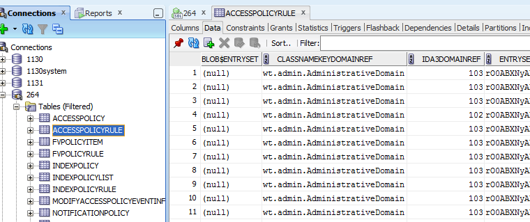

I don't yet delete ACLs through the database but here is the first layer of many I use to extract ACLs.

Yes and it helps to have sql developer open too as I left out the table name to deleted from as seen in your query..oops. 😉

Sorry about the sloppy post.
I just didn't realize how many non-pdmlink tables and views I was using for this.
Here are the major parts needed to really get into ACLs.
