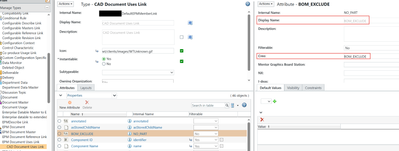

So I created a reusable boolean attribute, added it as a global attribute to the "CAD Document Uses Link" type and inserted the internal name of that attribute to the preference.
Then I created an assembly in Creo, added few components to it, added a designated component parameter to one of the components with boolean value YES on it and checked the assembly in.
I can see on the CAD assembly in Windchill that the designated component parameter ended up on the usage of the component in the assembly successfully, but that item is included in the WTPart structure. I also tried to add the attribute to the Part Usage type to see if it propagates from the CAD usage to the corresponding Part Usage during build, but for some reason it is not doing that. I also tried to set the preference EPM Service Preferences > Build Service Preferences > Attributes to be published on Occurrence to * just in case but that did not help.

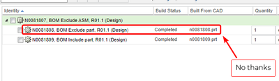

But still the WTPart structure includes the associated item:
Hi @N-Pyn,
If the requirement is that the CAD model should not be linked to any WTPart, then the Auto-Associate option must not be used during check-in.
Currently, Auto-Associate appears to be enabled, which is causing the system to create a link between the WTPart and the CAD document.
To avoid this association, please check in the CAD model with Auto-Associate disabled.

I don't know if it matters, but we have internal name "NO_PART" for both of the uses indicated there. We used a different display name to help our users, and used this mapping for the part occurrences:
Our most recent update was adding a mapkey so users can select the part instance they want to exclude, and it goes through the steps of setting the boolean and marking it as Designated.
