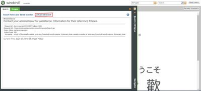

Features like advanced search, CAD document and Creo integrated CAD file creation are getting failed
SG_10227168
When i tried to create Cad document using WT part, it is showing following error:
Similarly in Creo Integration:
Advanced search:
Please help me to resolve this issue.  Ldap is gttc.com and EPM name prefix is com.gttc.

Hi @SG_10227168
Nothing happens without initial action .
What did happen before the error has started to show ?
Any config changes, server changers server name changes and so on.
PetrH

Is there any possiblity of changing thing from site administrator login. Because one time one more person used in client access worked on OIR and preference management in my absence, Is it the reason behind this. How can i resolve this issue error.
Thank you
Hi @SG_10227168
I guess that yes. Wrong OIR definition can case many troubles.
So I would start with all updated OIR and check if they are correctly defined.
Also check the Log files what error are presented in it.
PS> I would search domain Note . The OIR can contains some class that does not exists.
PetrH

HI @SG_10227168
Somewhere you have defined wrong declaration.
${domain}.Note
And also the error shows null point exception if it try to work with Name,.
So I guess that somewhere you try to define autopopulate name from somewhere and it is null. So it is not defined and that the error is thrown.
PetrH

HI @SG_10227168
I guess that the last changes to OIR could case the issue.
Please open a case with PTC because I can just guess and it is not helpful.
btw I can see there is something with .Note
check the internal name of Note in type and attribute management. If something has been change somewhere can be wrong definition.
Additionally
check all OIRs with Note on all levels, Site, Org , Product/Library

SG_10227168
(To:SG_10227168)
@HelesicPetr  @VladimirN
Windchill PDM functionality is working fine now. PDM user profile permissions got changed by someone. Now the problem has been resolved.
Thank you for your support.
