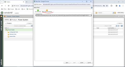

Features like advanced search, CAD document and Creo integrated CAD file creation are getting failed
When i tried to create Cad document using WT part, it is showing following error:
Similarly in Creo Integration:
Advanced search:
Please help me to resolve this issue.  Ldap is gttc.com and EPM name prefix is com.gttc.

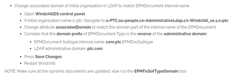

I am using 12.0.2.0 and everything is as per above case resolutions. Is there any chance that editing OIR of EPM or any other results into this kind of error.
And can you please help me with where can i get "EPMfix softtype" tool suggested in CS101558. I couldn't find that. Is it a shell command or what.
Thank you.
Thanks for reply,
where can i find, associatedDomain mentioned in point 3.

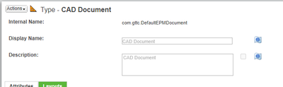

Plz check below image for Internal name of EPM
Earlier everything is working well. But all of a sudden these errors are poping up.
Thank you

btw I can see there is something with .Note
check the internal name of Note in type and attribute management. If something has been change somewhere can be wrong definition.
Additionally
check all OIRs with Note on all levels, Site, Org , Product/Library
PetrH
Hi @HelesicPetr
Checked everything intername is proper and there is no issue with OIR of Note. In all levels site level OIR only available.
