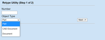

I thought once you created a part, you could not change it's type.  Is that really the case?
lgrant
(To:JHall)
I don't think you can re-type anything in Windchill
Javid_Nezhad
(To:lgrant)
Sure, you are able to retype objects in Windchill by proper tool.
You created this tool?
No, I haven't. It has been created by a local PTC partner.
Kind regards,
Javid
Javid,
Does the tool cleanup any orphaned data or does it just change the type?
The reason I ask is I wrote a tools to change type and it does the dB attribute cleanup.
In my use case the target type did not have the same attributes as the source type therefore remove from the dB was appropriate.
But this thread got me thinking a nice enhancement to the tool would be if the target type has attributes of the same type and name as the source type maybe an option keep the values.  Hmmmmm
David
You can change the sub-type but you cannot change the object type.
For example, if you have three sub-types of object type WTDocument can can toggle between the sub-types and even between a sub-type and the top level object type (in this example WTDocument).
 But if you do it keep in mind attributes tied to the current sub-type will be lost to the user (not to the dB). If you toggle back the attributes are still there.
This means if you have this situation and you change the sub-type you’ll need to do some dB cleanup or be left orphaned data in the dB.
