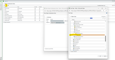

Now in OIR I don't see an option or listed Type for Manufacturer or Vendor Part .

You can explicitly create an OIR for the given types using new OIR action :

Both the subtypes  Vendor Part and Manufacturer Part are subtypes of the parent "Supplier Part".
It must be possible to have different OIRs for your Vendor Part and also for your Manufacturer Part. We have done it , one of them needed a different LC States and a non-auto generated Part Number. We did only through OIR.
Have both these Subtypes set as instantiable : YES  ?
