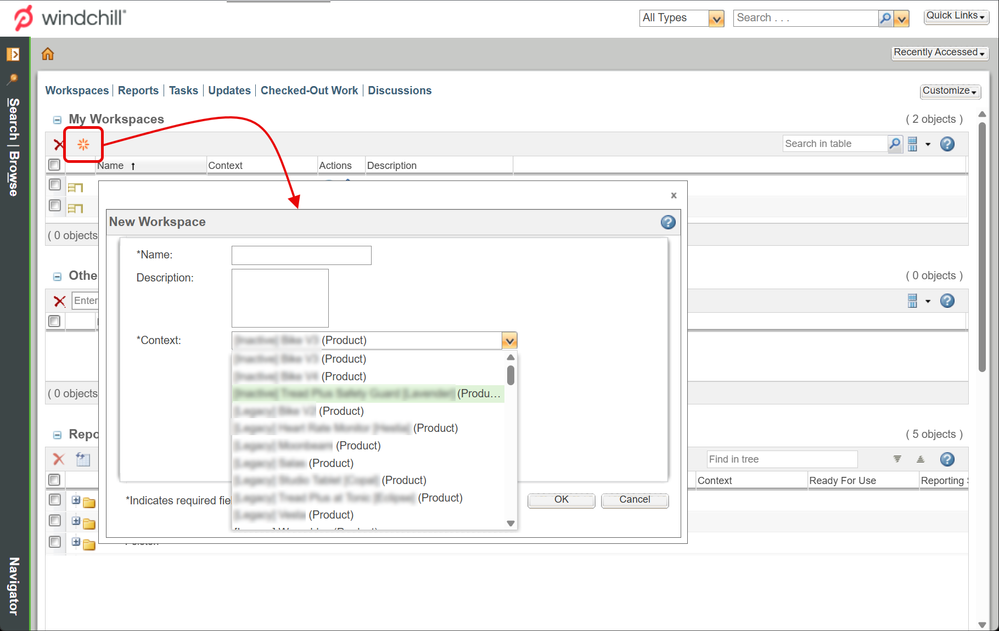

I have the same issue with the inability to identify the context type when creating a workspace from the Windchill home page. however, one of my TEST servers is currently exhibiting the desired behavior and i do not know what is different about this server. i have seen the same output in 1-2 screen shots for CS Articles in the PTC KB, but PTC TS cannot determine what is causing the context type to be shown after the name in ( ). anyone else experience this?
we are running wc12.0.2
Solution found by PTC Technical Support: Duplicate Container Names!
If you have a Library, Product or Project context with the same name, Windchill will display the context type in the New Workspace UI when invoked from the Windchill Home Page. I spent a lot of time comparing exported user preferences and log files trying to find what enabled this "feature".
The magic is that you must also be a member of both context teams for the context type to appear. That is why it was only working for me and not the others users I checked with.
I am going to validate this by creating a Project with the same name as a Product or Library that has the Organization added to the team which should enable this display for all users 🤞
Initial test with the Guest Role was unsuccessful. Looks like users, groups, or roles need to be added to a team role in the context.
PTC Technical Support has updated CS Article CS432444 which previously defined this capability as unavailable
https://www.ptc.com/en/support/article/CS432444

The change in display is only happening for my user accounts and not anyone else's. I am going to export user preferences today to compare and hopefully identify which preference I might have changed to enable the display of the context type.

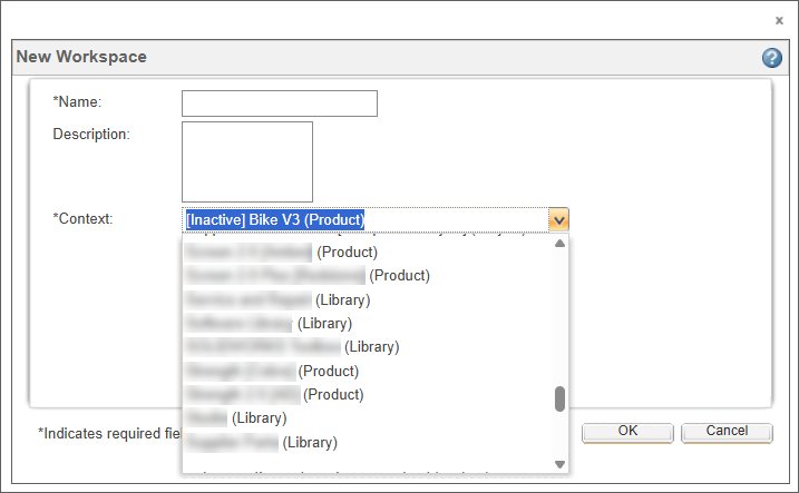

Here is another CS Article that shows the UI I am encountering: CS300051
Unfortunately, there is no mention of the context type being shown in the image, but it does contradict the information provided in CS432444 and certainly looks like a version newer than 9.0.

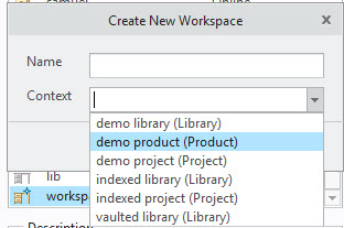

Noting on my system, the context is available in parenthesis from the Creo Server Manager drop down when creating a new workspace. If you use new Workspace from any Windchill page like the Home tab or from a product/library, the context type is not displayed. Please confirm Scott if you are seeing this on those pages I mentioned like creating a workspace from the home tab.
Yes, I am seeing the Context Type displayed in the Create New Workspace UI from the Windchill Home Page
