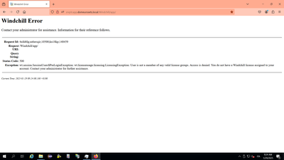

I am using Windchill PDMLink Release 11.2 and Datecode with CPS 11.2.1.2
Retrieved licensing file, but always menu obscured

You have to assignee the PTC License groups in the Participant administration to the users.

License file and screen in attached

Hi @FC_9723361
You have to remove the admin user from any group or profile.
Then you will see all the site options.
Usually it is cased by old license groups that are not used anymore.

hello, the problem is all user are not licensed and they can't use windchill

Hi @FC_9723361
wcadmin has always the access without the license.
PetrH
Great i know, but how is obscured Administrator user also other user have not license meanwhile the file is correct imported as the attached up

Hi @FC_9723361
