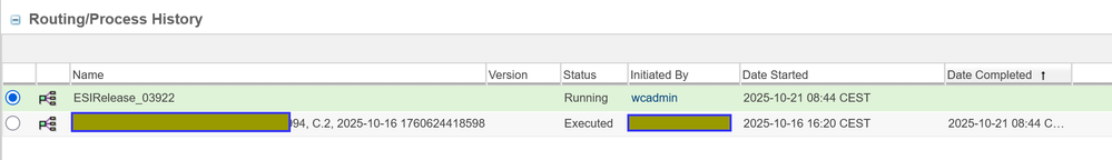

Version: Windchill 12.1
Use Case: I want to list all (promotion) processes that are currently running
Description:
Hi All
I have a small issue that i don't understand
I below a part of the process tab of a promotion request. As you can see the process is still running.

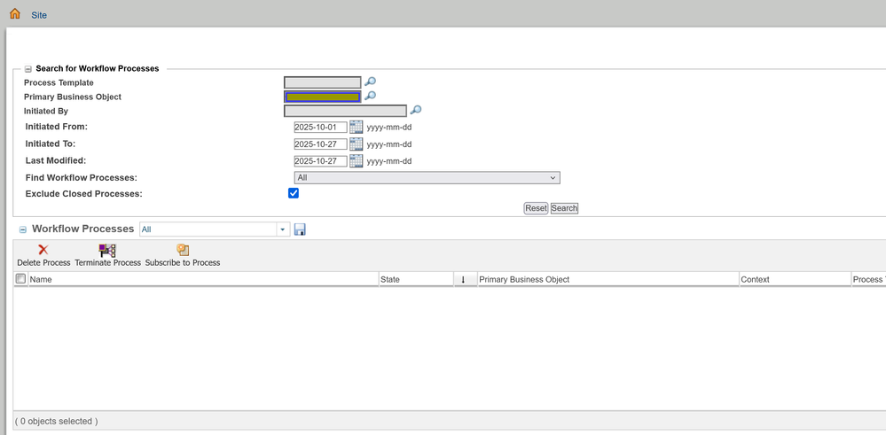

But when i lookup the same process is don't result in any processes.
I'm sure the process isn't finished. because for example in the promotion request there is a model with where the previous released version was B.2. It is now revised and the current released  version should become C.4. when the promotion process is over the B.2 should get the state 'replaced'. And (at least )not all of the objects has changed.
The reason i ask this is that i want all still running processes (i know there are more, but i don't want to check every promotion / change request etc manually)
Am i doing something wrong? OR is it possible that because of a (automatic)restart the process is corrupted? OR is it something else?
Additional info:
I also have tested the required promotion process template but then i don't see this running process
7 REPLIES 7
Try removing the "Last Modified" date? Is it possible the workflow wasn't modified today, and so it's getting excluded?
jw_CS
(To:joe_morton)
Oke this give in this case the expected result
Do you know if it is possible to search within Primairy Business Object ALL promotion requests and a single one?

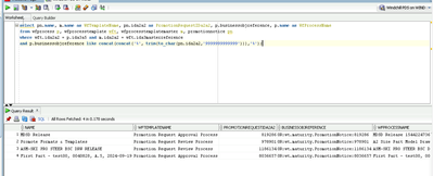

Fadel
23-Emerald I
(To:jw_CS)
you can further develope bzlow query ;
select pn.name, m.name as WfTemplateName, pn.ida2a2 as PromotionRequestIDa2a2, p.businessobjreference, p.name as WfProcessName
from wfprocess p, wfprocesstemplate wft, wfprocesstemplatemaster m, promotionnotice pn
where wft.ida2a2 = p.ida3a5 and m.ida2a2 = wft.ida3masterreference
and p.businessobjreference like concat(concat('%', trim(to_char(pn.ida2a2,'9999999999999'))),'%');
