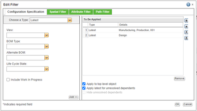

Hi PetrH,
The top part showing Design is desirable. Can you please clarify?
I applied the following filter:
Result:
We desire the following structure:
  • TEST12345, test12345, A.2 (Design)
    • TESTPART1, testpart1, A.1 (Manufacturing,  Production, 001)
TESTPART2 should be omitted from this filter.
Dean

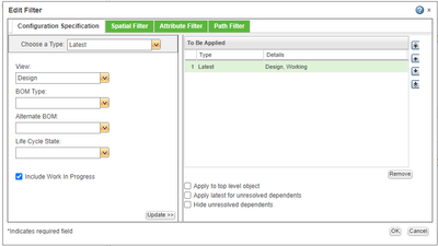

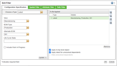

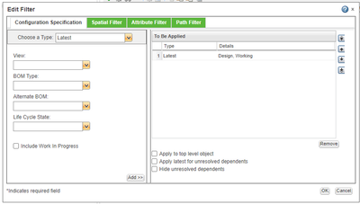

To be clear, even if you apply the filter to the individual part with a downstream equivalent (TESTPART1 (Design) == TESTPART2 (Manufacturing, Production, 001), you get the same issue:
Figure 1: Design filter
Figure 2: Applied filter for design view
Figure 3: Manufacturing 001 filter applied
Figure 4: Applied filter for manufacturing 001 filter

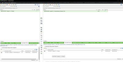

Equivalent link is properly established:
Figure 5: Equivalence is properly established in BOM Transformer
