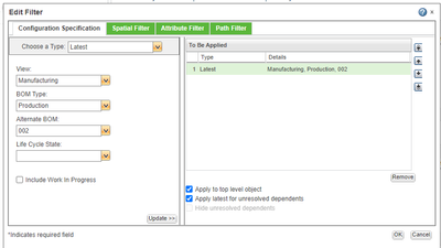

Filter does not exclude other manufacturing objects. We use plant-specific alternate BOMs and filter based on BOM number (i.e., 001, 002, etc.). Currently, filter does not work as-expected for a specific use case where the parent design object does not have a manufacturing part equivalent. Under the parent object structure when the filter is applied, all alternate BOM parts appear.

Hi @DW_10309702
I can see that you use just mfg filter and you apply this filter to the top level,
so the top-level part can not be resolved in this configuration.
I would suggest to add second filter for the design.

Hi PetrH,
The top part showing Design is desirable. Can you please clarify?
I applied the following filter:
Result:
We desire the following structure:
  • TEST12345, test12345, A.2 (Design)
    • TESTPART1, testpart1, A.1 (Manufacturing,  Production, 001)
TESTPART2 should be omitted from this filter.
Dean
