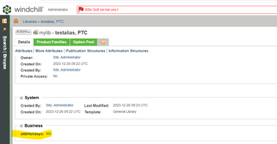

I am using. Windchill 12.2.2.12 and PDMLink 12.0.2.7
I have an attribute defined at my Library context that lists all the business holidays for the next few years. I'm trying to create an alias attribute for a Problem report type that gets created inside the library. The new problem report should have the attribute shown on the details page and along with it, list all the dates entered at the library context. After saving the change to the PR attribute, I switch back to the details of a PR and refresh. The attribute name is shown but it has no values (which should have come from the context/parent). From what I've read, I'm pretty sure this can be done, but I can't figure out the proper syntax. I used Logical Attribute Report to get the full internal names.
What I've tried so far:
containerReference^com.myCompany.myLibrary~attbHolidays
containerReference^com.myCompany.myLibrary~com.myCompany.myLibrary.attbHolidays
containerReference^IBA|com.myCompany.myLibrary~IBA|com.myCompany.myLibrary.attbHolidays
I also tried parentReference^ but I don't thing that is the right avenue.
When I try to show the attribute on the details page of a PR I get some variation of this error in the log:
Unable to find logical attribute: "com.myCompany.myLibrary~attbHolidays" with context: "WCTYPE|wt.change2.WTChangeIssue|com.myCompany.myLibrary~MBA|containerReference^WCTYPE|wt.inf.library.WTLibrary|com.myCompany.myLibrary~attbHolidays"

Have tested containerReference^com.myCompany.myLibrary~attbHolidays , it is wokring :

Awesome. Thanks so much for including the video.
