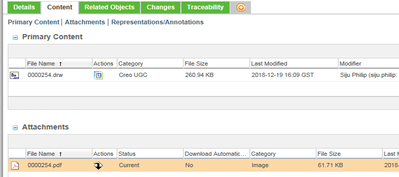

I have gone through most of the existing posts regarding this topic. Unfortunately I didn't find any answer matching my needs. I am new to windchill customization. We would like to publish only PDF after the drawings are released with promotion request.
I have managed to publish PDF to a WTdocument with AdditionalFilesPostPublishDelegate. However, I would like to auto publish pdf to drawing content as attachment instead of WTdocument.
I was also wondering how do other companies manage dxf files for laser cutting in windchill? Drawing DXF file created through auto publishing are useless for us as we can't feed that directly to machine. Also dxf scalling would be a issue.

Hello Graham,
I am looking to use auto publisher which will give us pdf as attachment. Refer attached image
Also if possible, pdf should have revision no. mentioned before extension.
Eg. 0000254REVX-.pdf

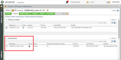

SV,
By "auto publish" do you mean by using publishing rules?
Anyway, I got this working including the REV in the attachment's filename.
In this example I reuse the pdf created by publishing and then simply connect it to the EPMDocument as an attachment with the the desired filename.
All done automatically upon publishing.
