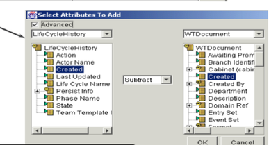

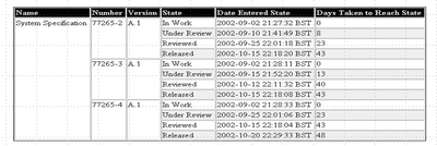

Example of a report showing how to calculate Days in a Lifecycle state.  This uses older UIs, but the methodology is the same in newer Query Builder

What you show on your last slide is exactly what I need.
You have to use example in slide 1 (database function Subtract)

As Jeff wrote:
You have to choose Database Function "Subtract" on select tab and then two date.
