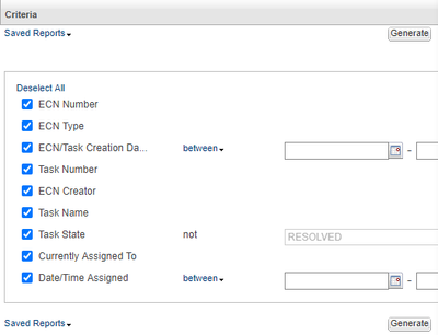

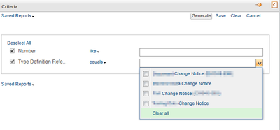

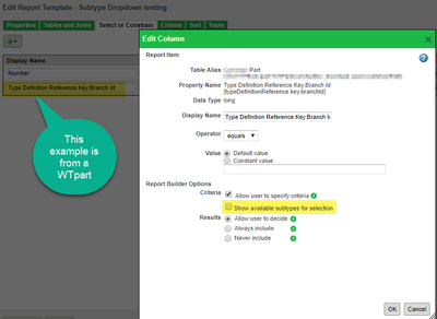

I created a report that shows me all the currently open CN's but using the top-level Change Notices. This report shows who the current assignee is and when it was assigned to them.
I have a request from one of my users that asked if all the CN sub-types ("ECN Type" shown below) could be shown in the criteria page when creating the report and have it so the user can select which CN's to report on.
I looked at it but couldn't figure out how to make that happen. Does anyone know how to do that?

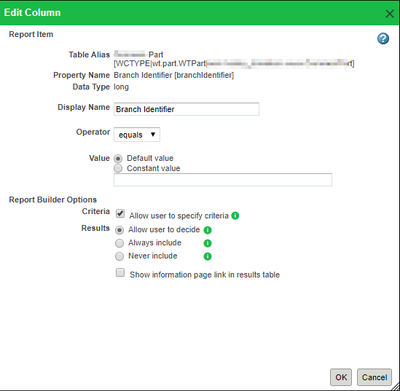

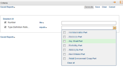

In 10.2 there was a way to do this in the arguments of the select tab. See here: https://support.ptc.com/cs/help/windchill_hc/wc102_hc/
I haven't tried this yet on 11.1. But I imagine it might be similar to the conversion of showing the Branch Identifier to display the Information Page icon.
aaronjlarson
(To:STEVEG)

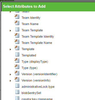

Found it.  It works the same, but this option isn't listed in the 11.1 help anywhere that I can find.  But if you follow the concept from the 10.2 help, regarding the "Type Definition Reference.Key.Branch ID" and the method for showing the information page icon in the 11.1 help it works.  See images.

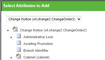

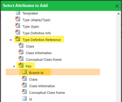

@STEVEG You're not getting it. Every object has a "Type Definition Reference.Key.Branch ID".  I just did it with our change notices, which also have subtypes.  See image.  This exists in 11.0 I'm 99% sure of it.  The QB updates in WC11  started from the first release of it.
You're right.  I am not getting it.  I don't see that option to select.
aaronjlarson
(To:STEVEG)
So a couple things.  In your OP you mentioned that you had subtypes of the Change Notice for which you'd like users to have the ability to choose from when running a report.  In this screenshot I see you have the Change Task as the object.  Do you have subtypes of the Change Notice, Change Task, or both?  Which object are you interested in?  Also, I see from your screenshot you are on the Criteria tab of the report builder.  You need to add the object's "Type Definition Reference.Key.Branch ID" onto the Select tab, which will allow you to edit that item's properties.
I have sub-types of the change notice and that is what I want to show.
The "Type Definition..." is not there either.  It has the Branch Identifier.  But not the TD Ref.Key.BID.

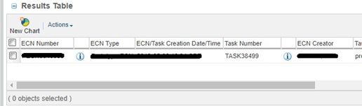

I found the topic in help center (see below image)
Marco
@Marco_Tosin  - yes you're right.  I did end up seeing that also.  I must have overlooked the "criteria" section of that table because applying that property has nothing to do with the report "criteria".  It is a little misleading and not very clear IMO.

The WTpart is listed as just "Part" in the tables menu.  If you're trying to do this for change notices  you should have this table in your query design:
Add the reportable item "Type Definition Reference.Key.Branch ID" to the Select tab from this table object.
Maybe I should have it but I don't.

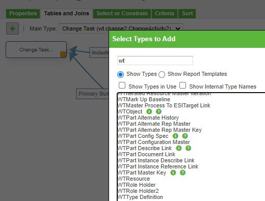

I figured out why mine did not have the "Type Definition Reference.Key.Branch ID" entry.
This report was originally created in either 9.1 or 10.2 but I was using the wt.change2.ChangeOrder2 instead of the wt.change2.WTChangeOrder2.
I started a report from scratch and noticed it was missing the WT.

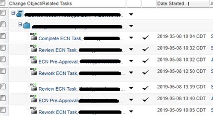

I found another difference between wt.change2.ChangeActivity2 and wt.change2.WTChangeActivity2
Using this CN as an example:
The report using wt.change2.ChangeActivity2 (No WT) will show only the last entry of the task in the history.  In this example only the last Rework for Matt will be shown in the report.
The report using wt.change2.WTChangeActivity2 will show all the entries above in the report and I don’t know how to show only the last one.

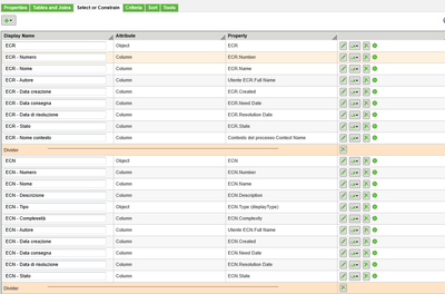

Hi Steve,
I apologize for the delay in responding, but I wasn't at the office on Friday.
In the first image you can see which objects are being searched for.
All the green arrows are outer joins to make the data come out even if one of the conditions is missing (for example an ECN that was not generated as a result of an ECR).
Some aliases are in Italian but it shouldn't be complicated to trace back to Windchill's internal name.

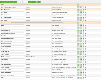

The other images are the selections made, divided by object type, also using the divider so that they are graphically detached during the search by users.
In the last image you can see two criteria used instead of joins in order to reduce the tables on which to search (this is a suggestion from my consultant).
Highlight you can read how the condition of the two criteria used is performed.
Marco

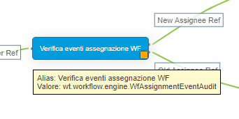

Thank you for the screenshots.  I am having trouble with a couple of the tables that should be picked.  The first one is verifica eventi assegnozione which translated check assignment events.  What is the actual table for that as I cannot find it?  The other ones, which I think are "User" are New Assign and Old Assign.  Is this correct?
Thank you,
Brian
Hi Brian,
this is the table you are searching for.
For new and old assign you are correct, table is WTUser that is used 5 times on the query builder.
This way you can use User value as filter.
Marco
