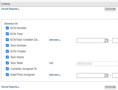

We have several sub-type Change Notices
I created a report that shows me all the currently open CN's but using the top-level Change Notices. This report shows who the current assignee is and when it was assigned to them.
I have a request from one of my users that asked if all the CN sub-types ("ECN Type" shown below) could be shown in the criteria page when creating the report and have it so the user can select which CN's to report on.
I looked at it but couldn't figure out how to make that happen. Does anyone know how to do that?

So a couple things. In your OP you mentioned that you had subtypes of the Change Notice for which you'd like users to have the ability to choose from when running a report. In this screenshot I see you have the Change Task as the object. Do you have subtypes of the Change Notice, Change Task, or both? Which object are you interested in? Also, I see from your screenshot you are on the Criteria tab of the report builder. You need to add the object's "Type Definition Reference.Key.Branch ID" onto the Select tab, which will allow you to edit that item's properties.
I have sub-types of the change notice and that is what I want to show.
The "Type Definition..." is not there either. It has the Branch Identifier. But not the TD Ref.Key.BID.
I'm on Windchill 11.1 M020.

I figured out why mine did not have the "Type Definition Reference.Key.Branch ID" entry.
This report was originally created in either 9.1 or 10.2 but I was using the wt.change2.ChangeOrder2 instead of the wt.change2.WTChangeOrder2.
I started a report from scratch and noticed it was missing the WT.
