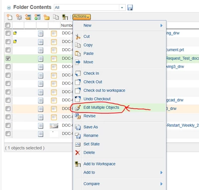

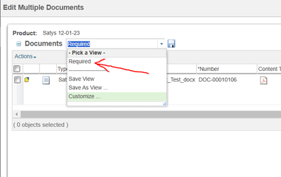

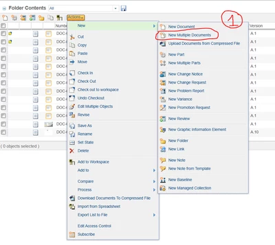

I am currently facing an issue with modifying the default "Required" view in Windchill. Despite having wcadmin permissions, I cannot replace or update this system-level view. Here's a detailed overview of what I've tried and observed:

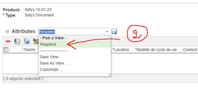

What I Need:
want to replace the existing default "Required" view with a custom configuration that better suits my requirements. I do not want to create a new view; my goal is to overwrite or modify the existing one.
The same thing for Edit Multiple Objects

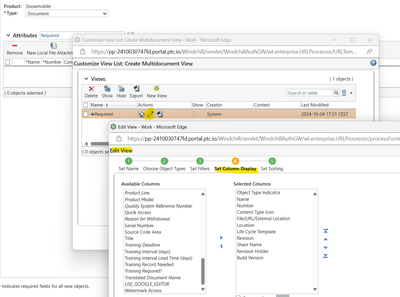

Steps I Followed:
  • I exported the "Required" view configuration to an XML file from Windchill.
  • I added the following TableColumnDefinition to the XML file:
<TableColumnDefinition>
  <name>IBA|fr.satys.plm.SecondaryReference</name>
  <locked>false</locked>
  <sortNumber>0</sortNumber>
  <treeColumn>false</treeColumn>
  <sortDescending>false</sortDescending>
  <hidden>false</hidden>
  <width>0</width>
</TableColumnDefinition>
  • I imported the updated XML file back into Windchill to apply the changes.
  • After completing the import, I refreshed the page to check if the changes were applied.
  • The newly added column IBA|fr.satys.plm.SecondaryReferencedid not appear in the "Required" view as expected.
NB:
When I modified the <name> of the view in the XML file (e.g., changing it to a new name) and imported it, I was successfully able to see the newly created view with the name I provided.
However, this is not the result I want — I need to modify the existing "Required" view directly, not create a new one.
⚠️And I can confirm that I am not even able to delete the existing "Required" view and replace it by importing my modified version.⚠️

Why don't you just edit the view from the UI and add the attributes Needed  :
