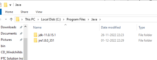

Unable to authentication ds directory server
windchill version :windchill- 12.0.2.16
Could not connect to the server. Check that the server is running. Details: javax.naming.CommunicationException: simple bind failed: 0.0.0.0:4444 [Root exception is java.net.SSLHandshakeException: No appropriate protocol (protocol is disabled or cipher suites are inappropriate)]

One of these should take care of it...
Install Windows OS patches
https://www.ptc.com/en/support/article/CS295289
Use the correct Java version, assuming WindchillDS 11.2.1.17, it should be Java 1.8.
https://www.ptc.com/en/support/article/CS346698
Update server/config/java.properties
https://www.ptc.com/en/support/article/CS332706
If this is not for an 11.x to 12.x upgrade, replace WindchillDS with OpenDJ..
https://www.ptc.com/en/support/article/CS388560
https://community.ptc.com/t5/Windchill/who-is-using-V3-ldaps-other-than-WCDS11-2-for-windchill-12-0-1-x/m-p/797478/highlight/true#M66922
