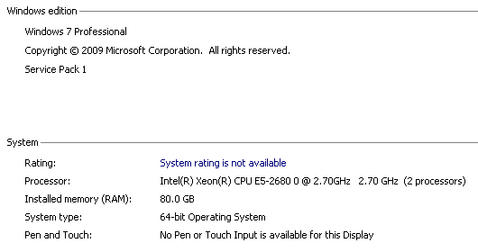

Thank you soooo much.  We do use virtual hosts and since we are linux to windows, we need to use SFTP.  We do use virtual hostnames like you do already but they are not on separate ports. I will try that next.  Can I ask what are the specs of your cad worker? OS, memory, cores/cpu?
Have you configured additional publishing queues?
https://www.ptc.com/en/support/article?n=CS43769
Without configuring additional publish queues you will not get increased through put when adding more workers.
