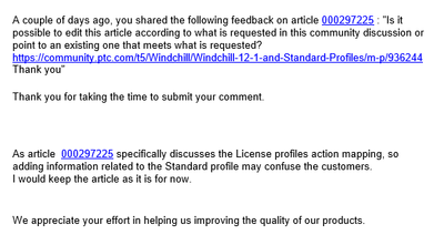

It is always possible to ask support to edit an article by adding clarification or even open a ticket with the same request.
I just did the first thing for this article by linking it to this discussion.
Let's see if it brings any results.
Marco
Below support reply to my request
Marco
