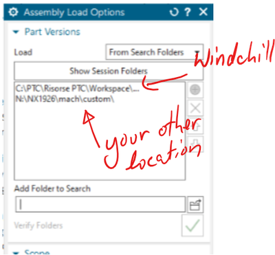

This could have to do with your NX model tree...
You have a lot of wavelinked bodies. Is your "Delay Model Updates" on? NX is particular about references - especially when it's connected to Windchill - and there are types of references Windchill doesn't (yet) support (like references from routing object geometries if you do tubing or harnesses).
Are the bodies you're linking available in the workspace (and therefore available in the %PTC_WFS_ROOT% folder of your cache)?
When you're opening your CAD, make sure to open with Assembly load options set to "Fully Load" too...
Great Dobi!!!!!
your advice works perfectly!!!!!
I missed in the assebly load options the custom folders where all the custom are uploaded. (Machine..etc...)
Great! Great Great!
Gianpaolo
But!!!!! When I start NX with Wgm connected the assebly load options is overridden and it links directly only to the workspace....the additional path has to be uploaded manually.

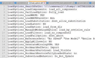

Ah, that's separate. That's an NX launch setting.
There exists a load_options.def file where you define this. I suspect you have something like this (the top line specifically is the folder search paths).
You can save a different load_options.def file in your NX user defaults location (that's defined in the ugii_env.dat potentially, depending on how you manage your environment variables for NX) that will have your desired folders in that top spot along with the "fully load" setting. So when you launch NX, it'll launch with whatever you default load_options.def file you define.

Hi Dobi,
I know about the Load_options.def but inside of this doc there is not info about Windchill.
Once I login with Server manger ON - on line this option is changed and NX link the Workspace.
Then I manually have to add the second load path to fix it.

Do you have a system admin or someone that controls your NX installation and launch? In our case, I control the site-wide load_options.def for the company and the users have an option to have their own. These separate out via Site/Group/User settings on the NX side via environment variables.
You can also make those edits before you open a file. They will apply in session.
What I'd do if I were you is make my own load_options.def file and save it somewhere and then point to it with an environment variable so that's the one that NX uses every time.
First, when you launch NX go to assembly load options and get the settings the way you want them.
I would change the LoadOptions line to - load_from_search_dirs so that it only looks at the folders you define in the upper section of the menu.
At the bottom of the window there will be some options to save this file. Do that and note the location.
Next, create an environment variable UGII_LOAD_OPTIONS and set the value as the address of the load_option.def file you created.
This can either be done in the ugii_env.dat or in your environment variables directly.
Relaunch NX.
It should now use your custom load_options.def by default every time you open a file.
