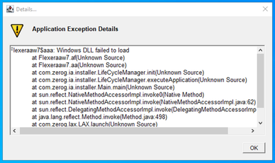

I am using Windchill PDMLink Release 11.2 and Datecode with CPS 11.2.1.0
we are doing upgrade from Windchill 11.1 to Windchill 12.1.2, and we are doing pre-Upgrade validation, we are installing windchill_DS 11.2 for windchill 12.1 , but windchill DS installation getting failed , so I am Unable to proceed further.
Here are the errors that I faced
The installation is aborting due to an unexpected error.
DEBUG 2023-07-28 08:43:15 - /ptc/windchill_11_2/WindchillDS/installation/ConfigWindchillDS.xml:81: exec returned: 6

Which operating system?  Windows Server 2022 has some special requirements to get the old Windchill DS to install correctly.
BenLoosli
(To:TA_10727713)
Windchill DS 11.2 requires Java_Home set to Java 11.
Windchill DS 11.2 requires LAX_VM set to Java 8.
Install 8 first, then 11.
Use RegEdit to modify the LAX_VM to Java 8. It is set in 2 keys.
  1.       Computer\HKEY_LOCAL_MACHINE\ System\ControlSet001\Control\Session Manager\Environment
  2.       Computer\HKEY_LOCAL_MACHINE\ System\ControlSet002\Control\Session Manager\Environment
Relog, then do your Windchill DS install.
This works on both Windows 2016 and 2019, not sure of 2022.

You don't actually have to 'install' Java, it's just needs to be somewhere on disk and have a couple of environment variables set.  No registry editing is required.  PTC's installer for Windchill DS's needs Oracle's version of Java 8.  It will not work with Amazon Corretto.

Windchill DS absolutely will run with Amazon Corretto. Been using it entirely since Windchill 11.2 - and used it (Java 11) to install Windchill DS 11.2 to Upgrade to 12.0.2.

I just tried this out again to be sure.
  1. Clean Windows installations
  2. Copy Amazon Corretto 8 JDK to local disk.
  3. Set JAVA_HOME environment variable
  4. Set LAX_VM environment variable
  5. Run PTC Solution Installer 11.2.1.0
Windows Server 2019 - No issue.  Windchill DS installs fine and runs fine.
Windows Server 2022 - Failure.  PSI will not run.  (To avoid this, use the Oracle JDK instead of Amazon Corretto.)
