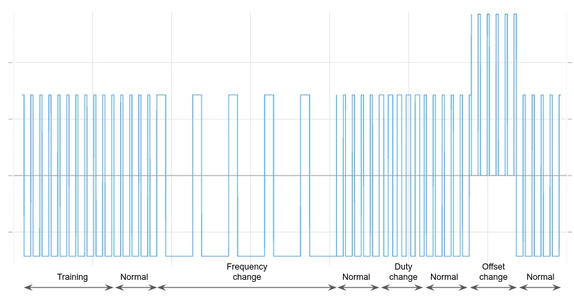

In particular, I've tested it with an emulated square signal that changes its characteristics over time against different anomaly alert configuration parameters to see how well the anomaly alert detects those changes. Below an image of the signal dataset.
From left to right that is:
  • 10 cycles of normal behavior (for training)
  • 5 cycles of normal behavior
  • 5 cycles at a different frequency (f_anomalus = f_normal/4)
  • 5 cycles with a duty=0.5
  • 5 cycles with an offset=1
Each cycle has 200 points (except for the f_anomalus cycles that have four times more points) and the property value change is configured to Always, so that each time the signal is 'sampled' a record is logged.

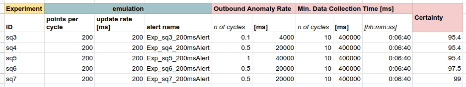

I configured the Anomaly Alert parameters taking into account the signal update rate, the number of points per cycle and the number of cycles that the parameter needs. Expressing that into formulas:
Outbound Anomaly Rate = points_per_cycle * update_rate * number_of_cycles
Min. Data Collection Time = points_per_cycle * update_rate * number_of_cycles
I also tested changing the certainty value (95, 97.5 and 99) while keeping the other parameters fixed.

- The only difference was noticed when the Outbound Anomaly Rate changed - the best result was detecting just one false positive (instead of two or three false positives) in the transition between Training and Monitoring states when the outbound anomaly rate was set equal to 0.5cycle

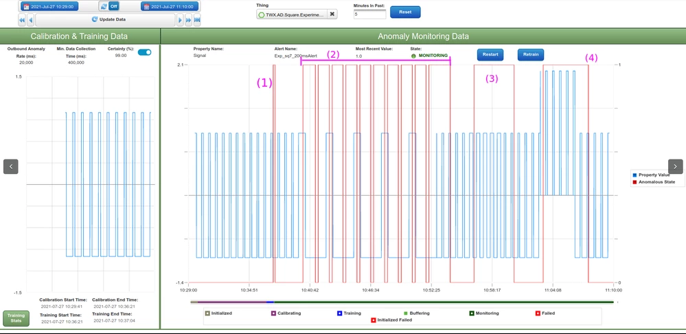

Here a screenshot of the result (experiment sq7):
It can be seen that the Anomaly Alert:
- (1) and (2): Did not work okay when switching from Training to Monitoring and when the signal frequency changed.
- (3) and (4). Worked okay when detecting the change of duty and when the offset was added.
So, the questions are:
  • How could the false positive when switching from Training to Monitoring (1) be eliminated?
  • Looking at (2), how can the Anomaly Alert stay in the the Anomalous State until the signal changes its frequency back to the normal value? Which Anomaly Alert parameter should be updated?

Your implementation of AD has done a relatively good job of finding things while raising questions. This is a good place to start with describing what you are seeing and understanding the behavior of what you are observing.
We are not sure why in (1) that there was an Anomaly Detected, unless there was some minor change in the underlying data or a hiccup with the stream. Assuming that the Anomalous section was exactly like the Training, then this should have not been marked as an Anomaly.
For (2), this should have been a big continuous anomaly, but instead it was marked as many small anomalies. This is ok in some ways, as it provides an indication that something is indeed different. When reviewed why this was split into many anomalies, which we can explain with the following: a predictive model is trained on training data then used to predict next point in time based on a window. The predictive model says that if it saw 0's for a certain interval, then the next value is likely to be 0 (as in the 0 segments in training). This is why it finds certain areas of (2) to be normal (non-anomalous).
