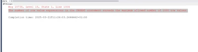

Jamal Ashraf
Mar 21, 2025 10:44 AM UTC
Thank you @wcui  for your response! Your suggestion helped a lot.
Now, I’m facing another challenge: when generating an SQL file with more than 1000 rows, SQL Server returns an error stating that the number of row value expressions in the INSERT statement exceeds the maximum allowed limit of 1000. This limitation is preventing me from executing bulk inserts efficiently.
Would you have any recommendations on how to handle this? Should I split the INSERT statements into batches of 1000 rows, or would using BULK INSERT be a more efficient approach? And how can i split it in SQL Server? Any recommendation
I’ve also attached a screenshot of the error for reference. Looking forward to your insights!
Mar 21, 2025 11:47 AM UTC
Hi @MA8731174
Glad to know it helped.
I'm not very proficient in SQL insert script, depending on the error content, the following link may be able to help you.
https://dba.stackexchange.com/questions/82921/the-number-of-row-value-expressions-in-the-insert-statement-exceeds-the-maximum
