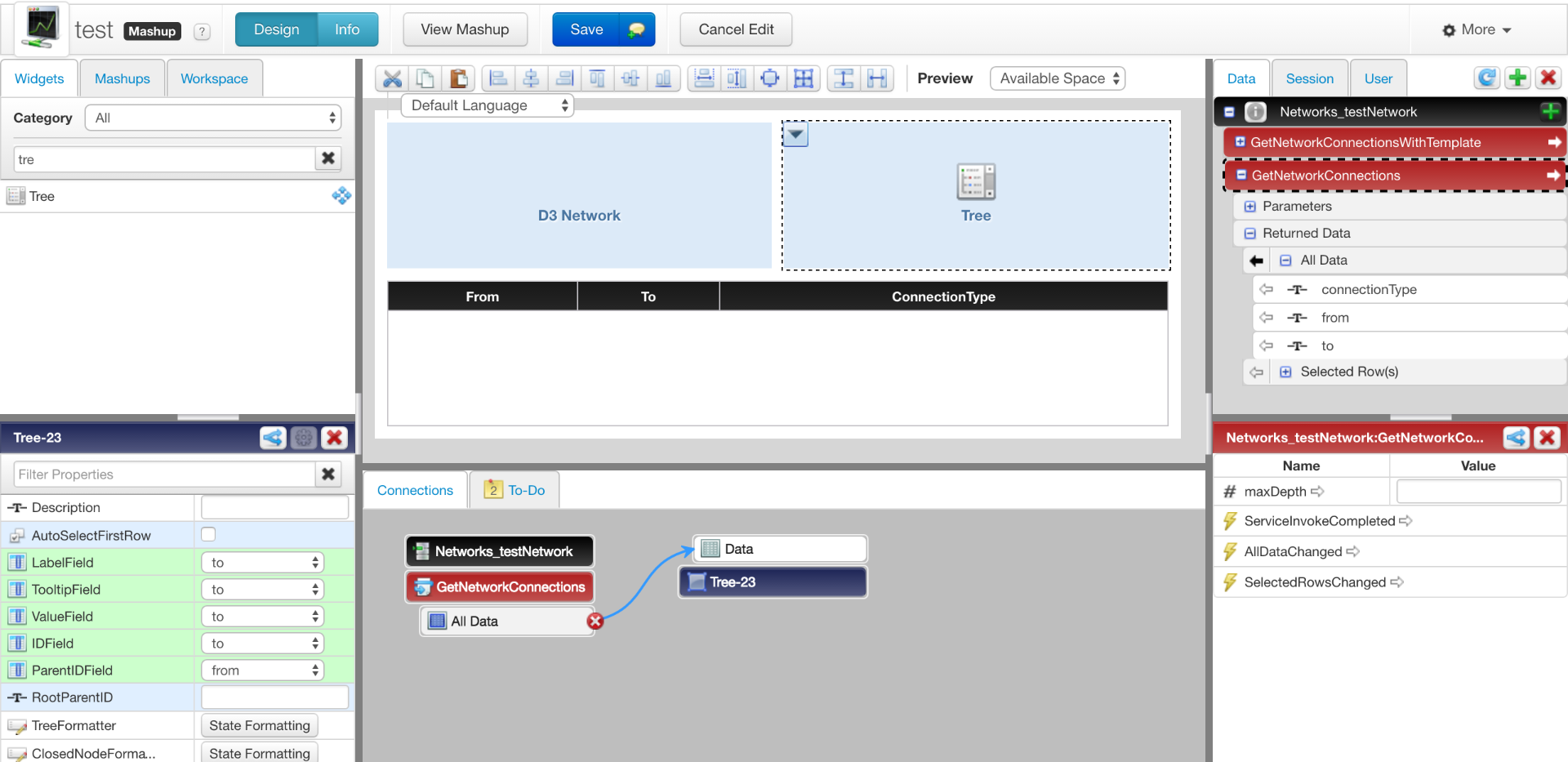

September 15, 2016

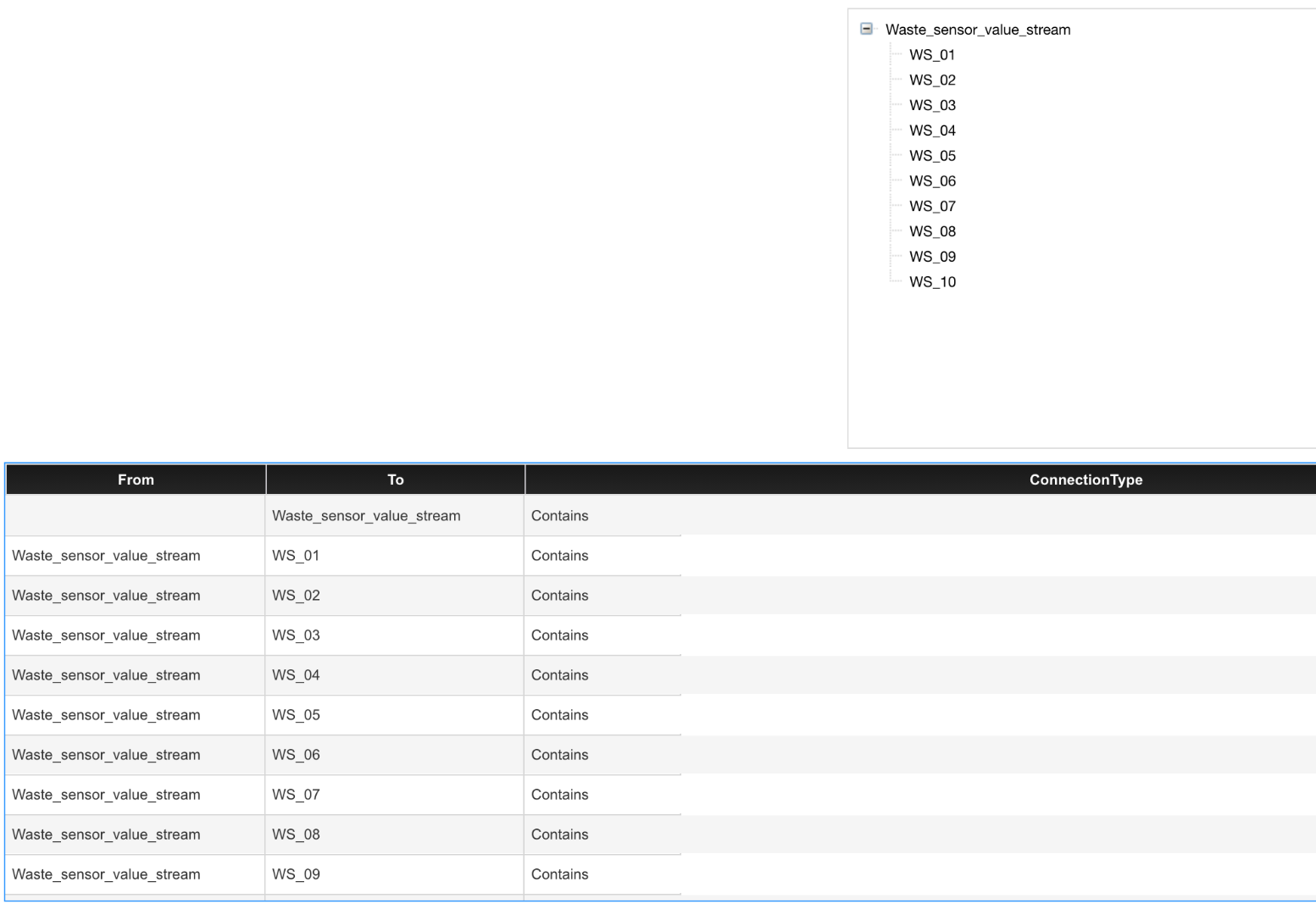

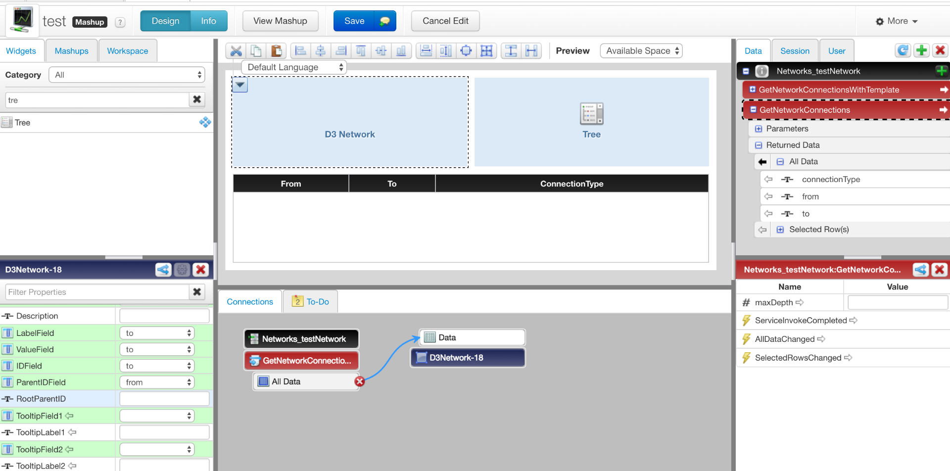

Hi Ankit,
here are the screenshots. It should pretty self explanatory.
September 15, 2016

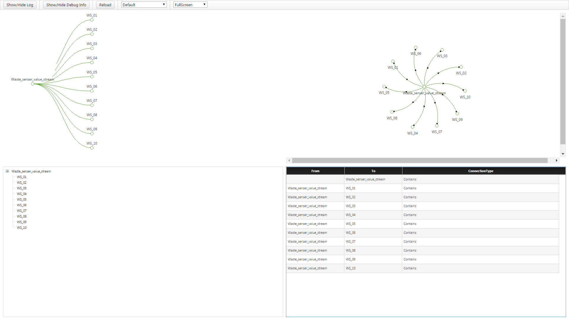

Hi Tomas,
Everything seems fine. Same steps works on my instance.
Screenshot from my instance.
Any error in logs?
