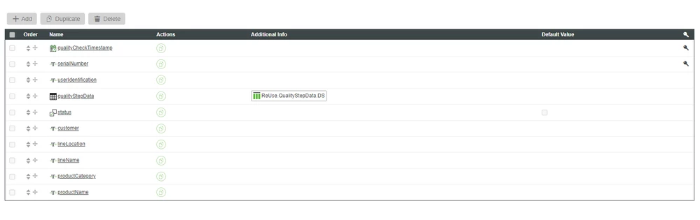

So first of all in my datatable i have entries and the datashape for each entry is as below:
qualityCheckTimestamp [DateTime]
serialNumber [DateTime]
MaterialNumber [String]
userIdentification  [String]
SData  [InfoTable]
status [Boolean]
ProDate [DateTime]
affix [String]
qualityCheckTimestamp and serialNumber are my primarykeys.
With FindDataTableEntries first of all i have set an index in configuration of the datatable. i have selected  userIdentifcation field as my index in Configuration. I have set an index then restart my thing then reindex service i have executed. Now in FindDataTableEntries  service in parameters(maxItems and values) in values parameter i have written in useridentification field for eg JHON and other all fields i have left empty because i need the data where the useridentification field will match to JHON  but it returns no data.
Can someone please give me details about my problem. Why i am unable to get the data? I have tried to set the serialNumber also as my index in Configuration and still it returns no data.

But you would still have the situation of a null value in a PK field. You might have to change something on the definition side of the DT, not the query side. (EDIT: Sorry, I was assuming the date value is null in the table, but it was just in the query, which should work)
At this point, if you want to investigate further, I'd suggest to create a fresh new DataTable for testing, using a simple datashape. Enter just two or three records and check if and how it works there - because FindDataTableEntries does work in general. Then work yourself forward and create another DataTable, using the qualityCheck DataShape, and repeat the testing. Maybe adding other indexes and reindexing causes the issue here.
To rule out you're calling FindDataTableEntries with spaces in the string argument I recommend writing a service that calls FindDataTableEntries instead of calling the service interactively.
Other than that, you could create a ticket with support.

Rocko
Dec 20, 2023 9:25 AM UTC
You might run into CS363928.
If so, try with an updated version or create a case on your own,
I also want to mention that you are maxing out datatables with 100k rows, so performance will not be too great. I would recommend to use SQL tables instead if you have this amount of rows.

Rocko
Dec 20, 2023 3:18 PM UTC
Quick follow-up due to some learnings:
1) make sure your Datashape does not have default values, or you provide values for them, as suggested per
https://www.ptc.com/en/support/article/CS306221 and https://www.ptc.com/en/support/article/CS292316
2) You probably don't have this, but it's a good reminder, make sure your Datashape does not contain field names already used in DataTables (key, location, source, sourceType, tags and timestamp)
Jamal Ashraf
Jan 8, 2024 1:21 PM UTC
This is below the fields of my Datashape which does not include (key, location, source, sourceType, tags and timestamp) and i am adding serialNumber in service FindDataTableEntries to find the entry but it is not working. It returns no data. Please help me in this regard
Rocko
Jan 8, 2024 1:34 PM UTC
Do any of those fields have default values defined? If so, FindDataTableEntries does not work and you will have to use QueryDataTableEntries with a query parameter (or remove the default value definitions)).
