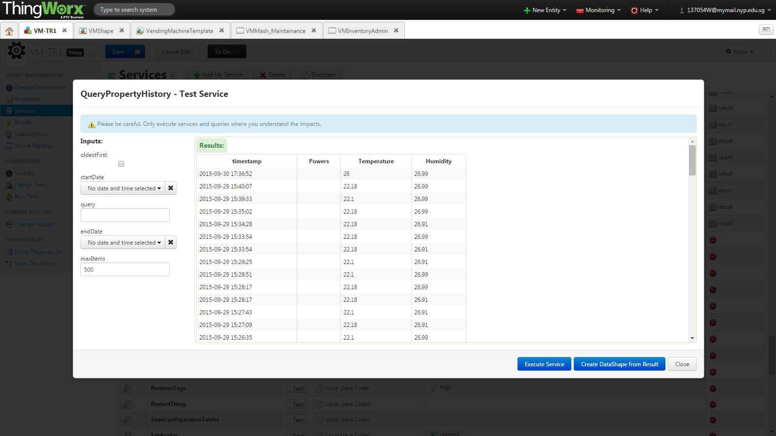

Just wanna ask why is the history stops at Sep 30 only even though I am still running it.

Can you try changing the values manually and see if they get logged?

Yea when I change the values manually it get logged, but when it auto change values  the history does not logged

Is this specific to the VM-TR Things or does this happen for all Remote Things? Can you try using the sample/ example.lua files in the EMS (along with the LuaScriptResource) to connect to a new RemoteThing, bind the properties and then logging them to a Value Stream?
