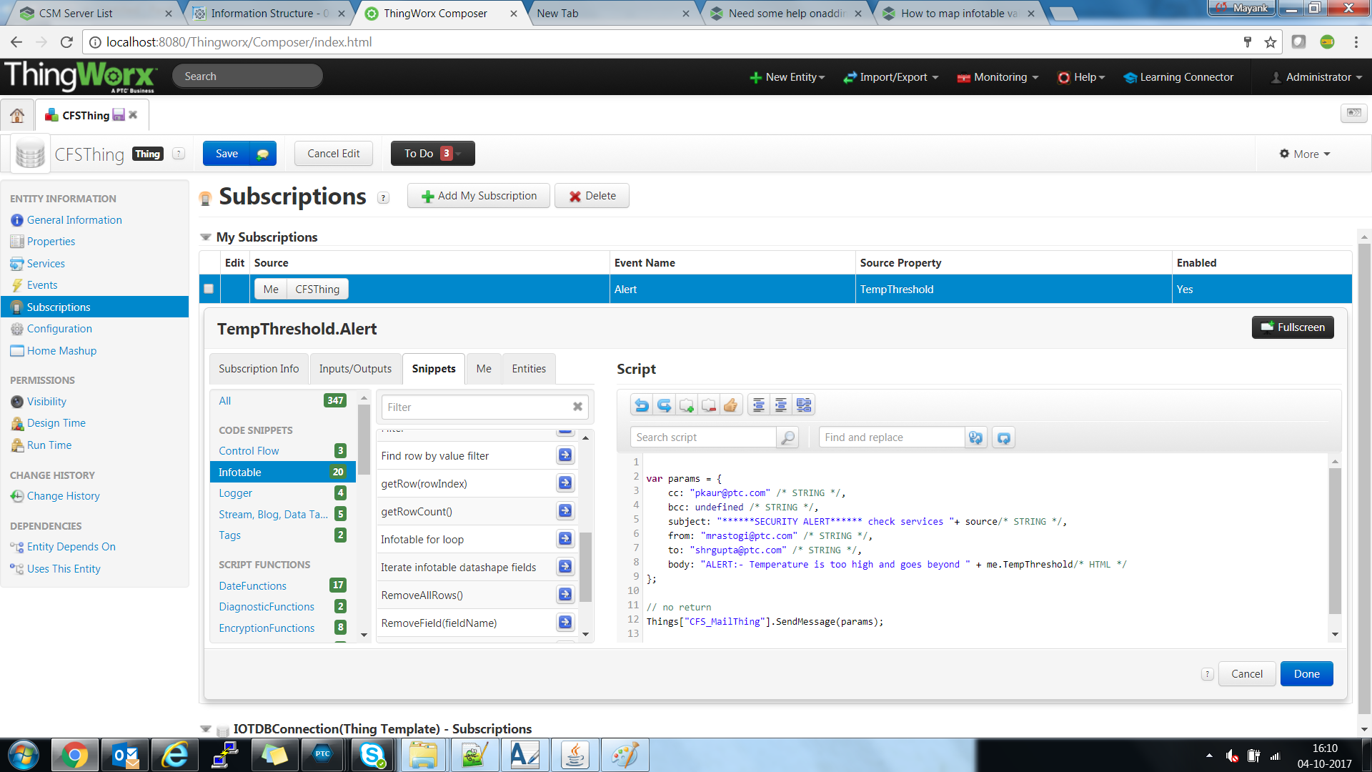

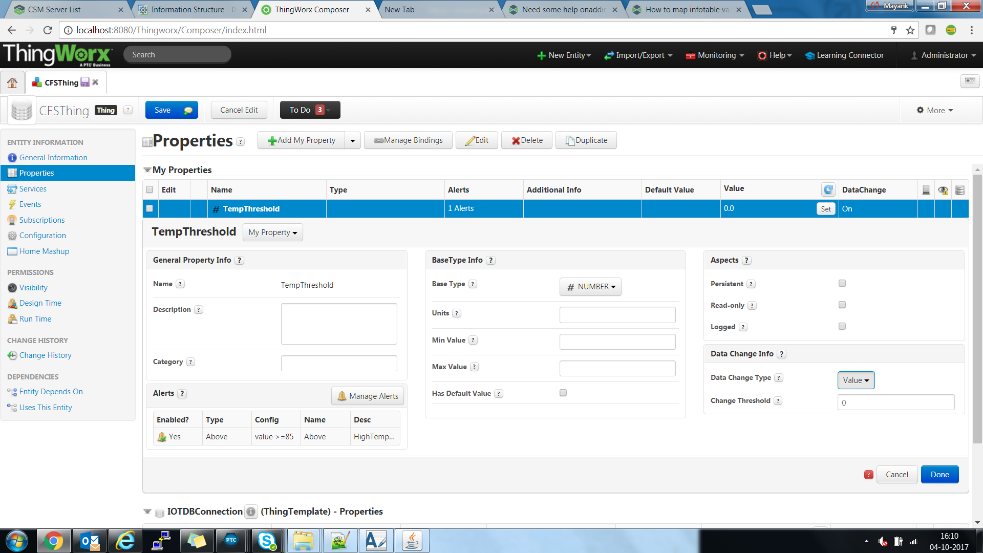

HI I am creating an alert using property and subscription. I am fetching some data from db and want to fire alert based on the value I am getting. As of for now I have to provide some value in property then the alert gets fired. I want to map the latest value of infotable[which I am fetching in service created by me] to the property value so that the alerts can be fired automatically based on the value.

Where do you have this infotable? Could you provide the structure?
In general I think you can create a subscription triggered on DataChange (the property you want to check), then compare the property value. If the condition is verified you can set alert Property to true.

HI lguagneliI have created a thing named as CFSThing, under this I have one service "GetData" which is fetching data from db, also the thing has one property "Threshold" and one subscription for sendmessage.

Your thing is connected to a ValueStream? The service GetData read from DB and then save data in some other place? You should use subscription to update TempThreshold.
