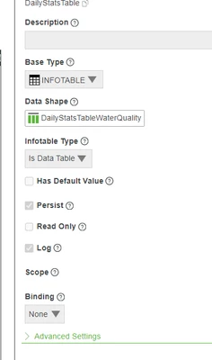

Infotable Type : Is data table
i was going to use info tables to store data like the max and min water level per hour , every hour new row is add to the info table with the max and min value of the level , all of this is fine but i know that info tables use ram in case of persist and log, and i want to do both, so i am thinking of selecting "infotable type" option to set it to "Is data table" because i think my thing worx version does not has the datatable creating option, so does this option "Is Data Table" will make this infotable property act as datatable and store the values in the database and not the ram ? also should i select persist and log normally or there is something here ?

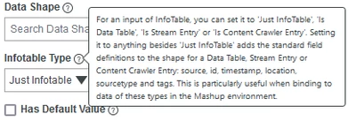

2) As the popup on the question mark explains "Is Data Table" will only add a couple of standard fields which come with a datatable to the property:
TBH I never used this on a property but only in the result definition of a Service, when you want to return rows from a Data Table to be used in a mashup. In this case "Is Data Table" controls if you can see the DataTable standard columns (key, location, source, source type, tags and timestamp) in the "Returned Data" of the service in the mashups Data tab.
Nov 28, 2024 2:04 PM UTC
so from what I understand I should only use log and only use info table to store the data needed to be shown on mashups ?
and if i selected "is data table" this doesn't mean it will be stored in database or hard desk but it will also store in ram ?! because it will help me a lot  if i can store it in database and not memory , i am planning on storing the data with the timestamp i want without considering the timestamp it is stored in the database with,

"is data table" does not really define how your values are stored. A Data Table is an entity of its own, it is a Thing with Base Thing Template "DataTable". You would have to create it explicitly and insert into it explicitly.
