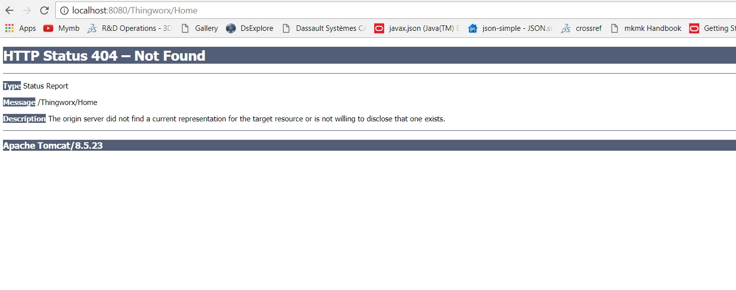

I am installing thingworx 8 on windows box having windchill 11 m030, & tomcat 8.5 along with postgresql9.4 but having an error when trying to hit Thingworx ,
The error is: The origin server did not find a current representation for the target resource or is not willing to disclose that one exists.
October 3, 2017
Hi Shubham,
Could you please share the application.log from ThingWorxStorage folder to track the issue?
October 4, 2017
java.io.IOException: The system cannot find the path specified

October 4, 2017
Hi Shubham,
This line in your application log :
2017-10-04 13:14:45.302+0530 [L: ERROR] [O: .t.s.s.l.LicensingSubsystem] [I: ] [U: SuperUser] [S: ] [T: localhost-startStop-1] C:\ThingworxPlatform;\license.bin: license file does not exist!"
says the license.bin doesn't exist in the ThingworxPlatform folder.
Did you create the ThingworxPlatform folder in your root directory and place your license.bin inside the folder? Also make sure you have read and write permissions for the ThingworxPlatform folder.
October 4, 2017
yes I did  ,also I have given required permissions to it & set the appropriate environment variable for that
October 4, 2017
Hi Shubham,
Have you set the library path to the PATH variable in the system environment variables?
If you haven't done so, could you please try the steps given in the following thread and let us know the result:
https://community.thingworx.com/community/developers/blog/2017/04/12/74-thingworx-does-not-launch-due-to-license-error-in-windows
October 4, 2017
Shubham,
Also try the workaround given in this article. Article Viewer | PTC
