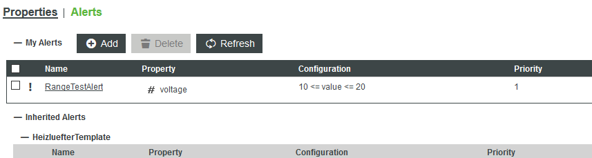

Ok, I'm not realy sure what bug you mean. I'm searching for a code example to override a alert.
I will get the alert from template:
to the thing:
