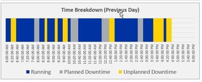

I am using the Bar Chart widget and using it as a column chart. I need help developing the service to get the data into an infotable that will have runtime in minutes for every 20 minutes with planned downtime in certain columns (3-4). I have an example of what the customer wants it to look like.

    Here is the example of the chart I am trying to populate:
    Here is the Here is the code I am trying to use.
