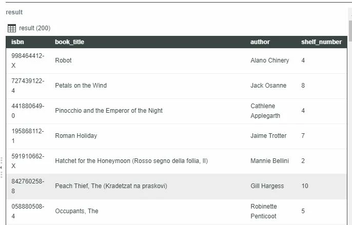

I am pulling external data into Vuforia Studio from Thingworx. However I want to filter the data being displayed. I attached a photo below of my infotable and my question is: Is it possible to only display data where "shelf_number" is equal to [x] within Vuforia?

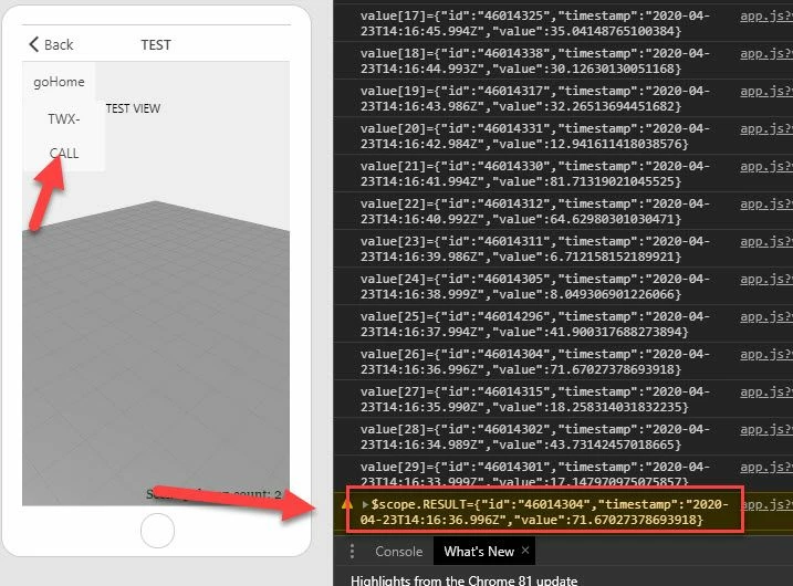

2.) You can call the data and filter it in the javaScript  loop / not so sufficient but for a simple case as in your example it could work fine:
//function which calls QueryNumberPropertyHistory
//with parameters

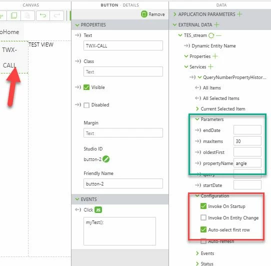

$scope.app.runMyTWXService = function() {
 var TWXmodelID = 'TES_stream';
 var serviceName = 'QueryNumberPropertyHistory';
 var parameters = {'propertyName': 'angle', 'maxItems': 30};
 twx.app.fn.triggerDataService(TWXmodelID, serviceName, parameters)
// myTest is called by UI button for testing see picture
$scope.myTest=function(){
$scope.app.runMyTWXService();
 $timeout(function()
 {console.log('retData')
 var retData=$scope.app.mdl['TES_stream'].svc['QueryNumberPropertyHistory'].data
 $scope.RESULT={}
 $scope.myFilter_min=50
 //any value to demonstrate a filter function here value should be > as min value
 var count=0;
 retData.forEach(function(value){
 console.log("value["+ (count++) +"]="+JSON.stringify(value))
 if(value['value'] > $scope.myFilter_min) $scope.RESULT=value;
//the first value which exceed the min filter
}) },600)
 $timeout(()=>{console.warn("$scope.RESULT="+JSON.stringify($scope.RESULT))},2000)
Then we can check e.g. the resutl in console:
For such static tables you can also pass the data as parameter in external data  and set the configuration to call it on statup - in this case you can call the service result directly :

Apr 23, 2020 11:51 AM UTC
Thank you. I was able to do that, my question is: Is there a way to filter what is shown based on a property. One of my values is "shelf_number" so I only want to display values on my data grid where "shelf_number === [x]".
